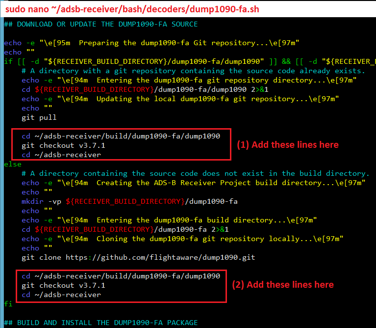

JP’s SCRIPT FAILS TO INSTALL dump1090-fa.
JP’s script builds dump1090-fa ver 3.6.3, then tries to install ver 3.7.1, and fails.
cd ${RECEIVER_BUILD_DIRECTORY}/dump1090-fa 2>&1
git clone https://github.com/flightaware/dump1090.git
cd ${RECEIVER_BUILD_DIRECTORY}/dump1090-fa/dump1090 2>&1
dpkg-buildpackage -b
dpkg-deb --build debian/dump1090-fa ..
dpkg-deb: building package 'dump1090-fa' in '../dump1090-fa_3.6.3_armhf.deb'.
Entering the dump1090-fa build directory...
Installing the dump1090-fa package...
dpkg: error: cannot access archive 'dump1090-fa_3.7.1_*.deb': No such file or directory
Checking that the dump1090-fa package was installed properly...
INSTALLATION HALTED!
UNABLE TO INSTALL A REQUIRED PACKAGE.
SETUP HAS BEEN TERMINATED!
The package "dump1090-fa" could not be installed.
Dump1090-fa setup halted.
WORKAROUND
(1) First execute following 3 commands:
sudo apt-get update
sudo apt-get install git
git clone https://github.com/jprochazka/adsb-receiver.git ~/adsb-receiver
(2) Next carry out following workaround for dump1090-fa
sudo nano ~/adsb-receiver/bash/decoders/dump1090-fa.sh
Ctrl+w, type
git pull
, press Enter key. Cursor will jump to:
git pull
Below this line, add following lines:
cd ~/adsb-receiver/build/dump1090-fa/dump1090
git checkout v3.7.1
cd ~/adsb-receiver -
Ctrl+w, type
git clone
Below this line, add following 3 lines:
git checkout v3.7.1
cd ~/adsb-receiver
Save (Ctrl+o) and close (Ctrl+x)

thanks @abcd567 worked ok for me.
evangel
Yep, my thanks too.
Updated my Intel Atom 64bit system
Nigel.
Already posted how to update to 3.7.1 using script
Thanks for pointing to your workaround in adsb-receiver thread.
Somehow I have missed it.
You have added --branch v3.7.1
to git clone
command, whereas I have left git clone
commansd as is, and used git checkout v3.7.1
as independent command immediately after git clone
. Both your and my methods are OK.
Your workaround will work with a FRESH install of adsb-receiver project, but if upgrading an existing install by re-running existing ./install.sh
, the install.sh
script will detect that source-code is already existing, and it will NOT use git clone --branch v3.7.1
. It will use git pull
, which will update existing code for version 3.6.3, and not for 3.7.1
This is the reason that in my workaround, I have added git checkout v3.7.3
at two locations, one immediately after git clone
and other immediately after git pull
Yes it was just a workaround. I needed v3.7.1 but no one else had provided an answer so had to google for a fix. Looks like your approach is a better long-term method so why didn’t you find it sooner?

sudo chmod +x ~/install_dump1090-mutab_5feeders.sh
sudo nano ~/install_dump1090-mutab_5feeders.sh
## COPY-PASTE CODE BELOW, SAVE, THEN RUN
cd ~/
./install_dump1090-mutab_5feeders.sh
NOTES:
- FOLLOWING CODE TO BE COPY-PATED IN FILE
install_dump-1090-fa_5feeders.sh
- REPLACE XXXXX, XX.XXXX, YY.YYYY, ZZZ WHEREVER THESE OCCUR BY THEIR ACTUAL VALUES.
#!/bin/bash
echo "updating....."
sudo apt-get update
## DUMP1090-MUTABILITY INSTALLATION
echo "installing dump1090-mutability......"
echo "Installing packages needed to build, and needed to fulfill dependencies...."
sudo apt install -y git debhelper librtlsdr-dev lighttpd
sudo apt install -y rtl-sdr build-essential cron curl
sudo apt install -y fakeroot libusb-1.0-0-dev pkg-config
echo "Installation of dump1090-mut dependencies & tools completed"
echo "CLONING THE SOURCE FILES....."
sudo git clone https://github.com/mutability/dump1090.git dump1090-mut
echo "MOVING INTO CLONED DIRECTORY ...."
cd /home/pi/dump1090-mut
echo "BUILDING DUMP1090-MUTABILITY PACKAGE ...."
sudo dpkg-buildpackage -b
echo "INSTALLING THE DUMP1090-MUTABILITY PACKAGE ...."
cd ../
sudo dpkg -i dump1090-mutability_1.15~dev_*.deb
echo "CONFIGURING THE WEB SERVER ...."
sudo lighty-enable-mod dump1090
sudo systemctl force-reload lighttpd
echo "STRETCH WORKAROUND (Ajax call Fail) ...."
sudo wget -O /etc/udev/rules.d/rtl-sdr.rules "https://raw.githubusercontent.com/osmocom/rtl-sdr/master/rtl-sdr.rules"
echo "Adding Terrain Limit Ring ...."
sudo wget -O /usr/share/dump1090-mutability/html/upintheair.json "http://www.heywhatsthat.com/api/upintheair.json?id=XXXXXXXX&refraction=0.25&alts=12192"
## IMPORTANT NOTE: REPLACE XXXXXXXX BY YOUR HEYWHATSTHAT ID
sudo dpkg-reconfigure dump1090-mutability
echo "Installation of dump1090-mutability completed"
## PIAWARE INSTALLATION
echo "installing Piaware data feeder......"
sudo wget http://flightaware.com/adsb/piaware/files/packages/pool/piaware/p/piaware-support/piaware-repository_3.7.1_all.deb
sudo dpkg -i piaware-repository_3.7.1_all.deb
sudo apt-get update
sudo apt-get install -y piaware
sudo piaware-config allow-auto-updates yes
sudo piaware-config allow-manual-updates yes
echo "Adding Flightaware Feeder ID......"
sudo piaware-config feeder-id XXXXXXXX-XXXX-XXXX-XXXX-XXXXXXXXXXXX
## IMPORTANT NOTE: REPLACE XXXXXXXX-XXXX-XXXX-XXXX-XXXXXXXXXXXX BY YOUR ACTUAL FEEDER ID
echo "Restarting Piaware Data feeder ...."
sudo systemctl restart piaware
## WIEDEHOPF's GRAPHS INSTALLATION
echo "Installing wiedehopf's Graphs...."
sudo bash -c "$(wget -q -O - https://raw.githubusercontent.com/wiedehopf/graphs1090/master/install.sh)"
echo "Installation of Graphs completed..."
## PLANEFINDER DATA FEEDER INSTALLATION
echo "installing Planefider data feeder......"
wget http://client.planefinder.net/pfclient_4.1.1_armhf.deb
sudo dpkg -i pfclient_4.1.1_armhf.deb
echo "installing pfclient configuration......"
PF_FILE="/etc/pfclient-config.json"
sudo chmod 666 $PF_FILE
sudo cat <<\EOT > $PF_FILE
"tcp_address":"127.0.0.1",
"tcp_port":"30005",
"select_timeout":"10",
"data_upload_interval":"10",
"connection_type":"1",
"aircraft_timeout":"30",
"data_format":"1",
"latitude":"XX.XXXX",
"longitude":"YY.YYYY",
"sharecode":"XXXXXXXXXXXX"
EOT
## IMPORTANT NOTE: REPLACE XXXXXXXXXXXX, XX.XXXX, and YY.YYYY BY YOUR ACTUAL VALUES
echo "Installation and configuration of PFClient completed....."
echo "Restarting PFClient ....."
sudo systemctl restart pfclient
## RB24FEEDER INSTALLATION
echo "Starting installation of RadarBox24 feeder....."
sudo bash -c "$(wget -O - http://apt.rb24.com/inst_rbfeeder.sh)"
## MLAT-CLIENT INSTALLATION
echo "Installing mlat-client....."
sudo apt-get install mlat-client
echo "Starting automatic configuration of RB24 feeder....."
RB24_FILE=/etc/rbfeeder.ini
sudo touch $RB24_FILE
sudo chmod 666 $RB24_FILE
sudo cat <<\EOT > $RB24_FILE
[client]
network_mode=true
log_file=/var/log/rbfeeder.log
key=XXXXXXXXXXXXXXXXXXXXXXXXXXXXXXXX
sn=
lat=XX.XXXX
lon=YY.YYYY
alt=ZZZ
sat_used=0
sat_visible=0
[network]
mode=beast
external_port=30005
external_host=127.0.0.1
[mlat]
autostart_mlat=true
EOT
## IMPORTANT NOTE: REPLACE XXXXXXXXXXXX, XX.XXXX, YY.YYYY, ZZZ BY YOUR ACTUAL VALUES
echo "Restarting rbfeeder...."
sudo systemctl restart rbfeeder
## OPENSKY FEEDER INSTALLATION
echo "Installing Opensky-network Feeder ....."
wget https://opensky-network.org/files/firmware/opensky-feeder_latest_armhf.deb
sudo dpkg -i opensky-feeder_latest_armhf.deb
## FR24FEED INSTALLATION
echo "Starting automatic configuration of FR24 feeder....."
FR24_FILE=/etc/fr24feed.ini
sudo touch $FR24_FILE
sudo chmod 666 $FR24_FILE
sudo cat <<\EOT > $FR24_FILE
receiver="beast-tcp"
host="127.0.0.1:30005"
fr24key="XXXXXXXXXXXXXXXX"
bs="no"
raw="no"
logmode="0"
windowmode="0"
mpx="no"
mlat="yes"
mlat-without-gps="yes"
use-http=yes
http-timeout=20
EOT
## IMPORTANT NOTE: REPLACE XXXXXXXXXXXX BY YOUR ACTUAL FR24KEY
echo ""
echo ""
echo echo "Starting installation of FR24 feeder....."
sudo bash -c "$(wget -O - http://repo.feed.flightradar24.com/install_fr24_rpi.sh)"
sudo systemctl restart fr24feed
echo ""
echo "Installation and configuration of FR24 Feeder completed....."

In my post above, I have added script for dump1090-mutability. It has now two scripts:
(1) DUMP1090-FA + 5 FEEDERS + GRAPHS
(2) DUMP1090-MUTABILITY + 5 FEEDERS + GRAPHS
