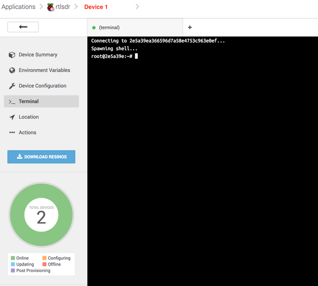

Device Terminal
  • Connect to any device from any location, even if you’re not on the local network.
  • Debug the application. You could for example change the scripts I provided completely, push again to resin and have a completely different result. It allows flexibility on scale.
