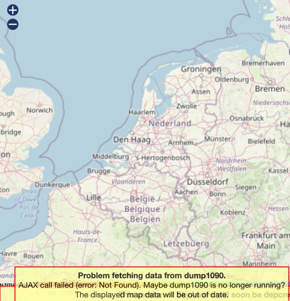

When I click on live view data
I don’t see any plane. Only an error

Just checked it, doesn’t work for me as well.
But looking at the URL it does have the port 8080 on it. It’s even not loading because i also use readsb installed by the automatic script provided by @wiedehopf
I would assume that’s the reason why this URL is not working properly
Oh, thank you, so it is “normal”?
So I did not do something stupid. :blush:

The local Skyaware is still working. The only thing is the link in your Flightaware Profile.
To be honest i never used this link
That interface only works with dump1090-fa running.
If that works for you, you’re not running readsb …
