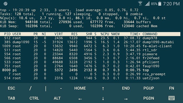

Very High CPU Usage of Dump978
Although tere are no UAT planes, the dump978 has highest share of CPU usage, more than dump1090 which has over 100 planes !!!
As with dump1090, most of the cost of dump978 is in the demodulator (dump978 really isn’t much more than a detector/demodulator + error correction) which has to run on every incoming sample regardless of how many signals it actually finds.
I did not quiet get this. My logic is as follows:
If there is zero signal, there should be zero samples (the case of my dump978), while if there are huge number of signals, there should be huge number of samples (the case of my dump1090).
The dongle is acting as a software defined radio (see e.g. the top half of this diagram).
It digitizes part of the received radio spectrum at a rate of around 2-2.4MHz and passes that raw data on to dump978/dump1090.
Then all of the scanning for signals in the raw data (the “baseband processing” in the diagram) happens on the Pi.
So dump978/dump1090 is given >2 million samples per second, every second, even if there is no real signal in there. You don’t know if there’s a signal there or not until you do the processing of the raw samples.
Now this detailed explanation made things clear. Thank you Oliver.
