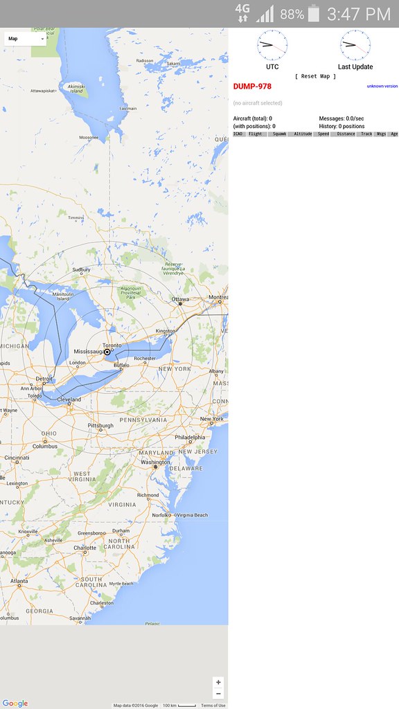

Map generation via uat2json
uat2json writes aircraft.json files in the format expected by dump1090’s map html/javascript.
To set up a live map feed:
  1. Get a copy of dump1090, we’re going to reuse its mapping html/javascript:
$ git clone github.com/mutability/dump1090 dump1090-copy
  1. Put the html/javascript somewhere your webserver can reach:
$ mkdir /var/www/html/dump978
$ cp -a dump1090-copy/public_html/* /var/www/html/dump978/
  1. Create an empty “data” subdirectory
$ mkdir /var/www/html/dump978/data
  1. Feed uat2json from dump978:
$ rtl_sdr -f 978000000 -s 2083334 -g 48 - | \ ./dump978 | \ ./uat2json /var/www/html/dump978/data
#item 4) not executed, see note (3) below.
  1. Go look at localhost/dump978/gmap.html
NOTE:
(1) path in github page was /var/www/. Used instead /var/www/html/ (for jessie)
(2) new folder name proposed in github was dump978map. Used dump978 to match jprochazka’s script.
(3) I did not execute step (4) as this was already included in jprochazka’s file adsb-feeder/build/dump978/dump978-maint.sh
(4) Tweaked config.js & gmap.html (both in /var/www/html/dump978 folder) to change title from “dump1090” to “dump978”.
Screenshot taken when there were no UAT planes, which appear only occassionally after long wait.
