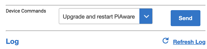

When upgrading PiAware, using the Upgrade and restart PiAware command is all that’s needed correct? It will auto upgrade dump1090 if it’s needed?
No, there’s a seperate command for dump1090-fa and dump978-fa
Gotcha. So run those commands as well?
I would first upgrade dump1090
If you have a 978 receiver as well then do that one as a second step.
Final step upgrade piaware.
Piaware is dependant on dump1090/978 so that should be done as the last one.
Or ssh into the raspberry pi and give the command
sudo apt update && sudo apt upgrade -y
To do all the installed packages at once :wink:
I did a little homework into this; the ‘Upgrade and Restart PiAware’ does actually upgrade dump1090 and dump978 as well. So if you just want to do a simple upgrade, that’ll do the trick; you don’t need to run the ‘Upgrade dump1090’ or ‘Upgrade dump978’ commands separately.
What it doesn’t do is upgrade to the latest Raspbian Core OS packages, e.g. the latest SSH. To do that you need to do what @tomvdhorst is suggesting, and go into the command line and run sudo apt update && sudo apt upgrade -y
Not 100% clear to me if you absolutely have to run the core OS upgrades; as a former sysadmin I’d generally lean toward doing it because it will inevitably include security patches, etc. But your PiAware is probably behind your home firewall and not exposed to the public internet, so just doing the ‘Upgrade and Restart PiAware’ command is likely good enough.
I always advise to do the apt update and apt upgrade path due to the underlying dependencies of piaware and dump1090-fa.On installation they will need some additional software and by executing these 2 commands you are sure all packages are up to date.
