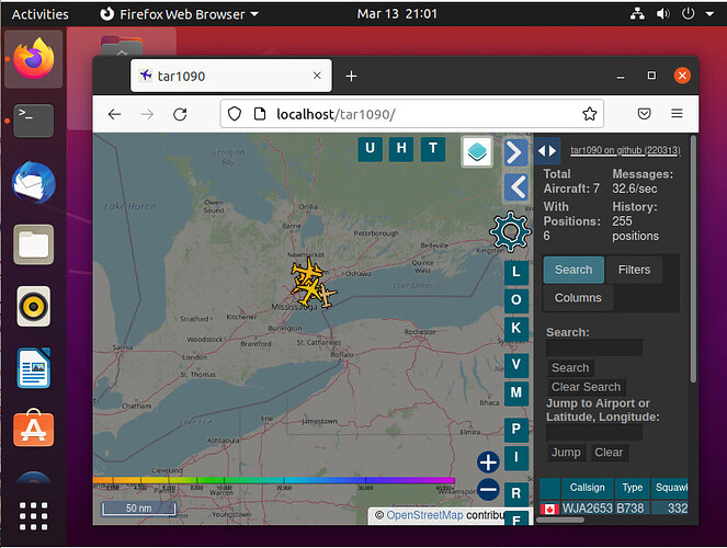

Problem fetching data from the server:
Seems the decoder / receiver / backend isn’t working correctly!
Are you running readsb in net only mode?
readsb can’t access the Airspy directly as SDR device. This is documented in the readsb readme
