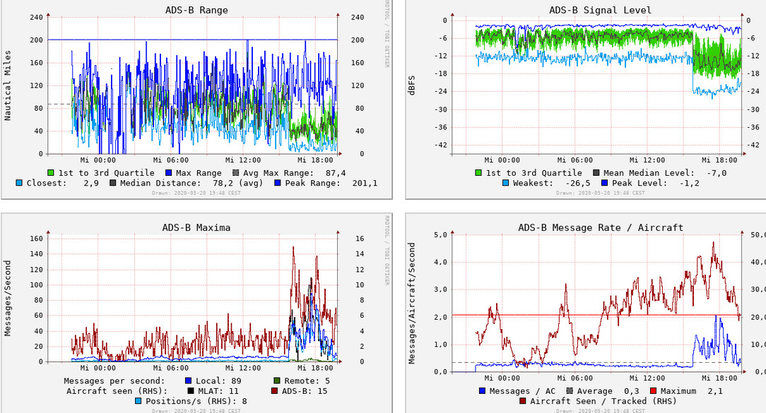

what also looks strange is the daily total of tracked positions (right side about 50.000 a day) compared to the few positions displayed on the graph left side. In the beginning there where some 20.000 at the 2nd/3rd graph and now it less than 10.000 per column.

Well, setting the 43.9dB at 16:00 these are the results

leave it with this value for the next 24 hours.
With this low traffic at the evening it is a mission impossible to determine the correct gain settings.
Your first plot shows too much gain. After i got my new Jetvision antenna i needed to reduce it down to 40.2 which gave me the best value keeping an eye on the messages > 3dbFS (should be max 5%)

This is the graph with the time i installed the filter. before that gain was at 40.2
Consider the small peak the same day in messages > -3dBFS
I had gain set to “-10” for a few hours, but it did not work, so i went down to 49.6 which seem to be fine now.
Looking at the ADSB Signal Level chart, the early part of the light blue line shows unusually high levels. This is the minimum signal level seen at the receiver. This implies to me a high level of background noise/ interference. That level could easily mess with the ADSB signals. When you reduced the gain, the minimum signal level reduced and the higher levels changed but into a more normal range. My FA receivers seem to have the light blue line around -24, my airspy receiver drops to about -30.
