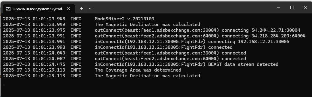

This is just an experiment:
Feeding FlightFeeder’s data to AdsbExchange from Windows 11, using ModeSMixer2.
Double click run.bat to start feeding.
The contents of run.bat are as follows
@echo off
cmd /c modesmixer2_windows_x86_64.exe ^
--inConnectId 192.168.12.21:30005:FlghtFdr ^
--outConnect beast:feed1.adsbexchange.com:30004 ^
--outConnect beast:feed2.adsbexchange.com:64004 ^
--web 8787 ^
--location 43.58:-79.62
PAUSE
exit
This is the command window started by the batch file:
Click on Screenshot to See Larger Size

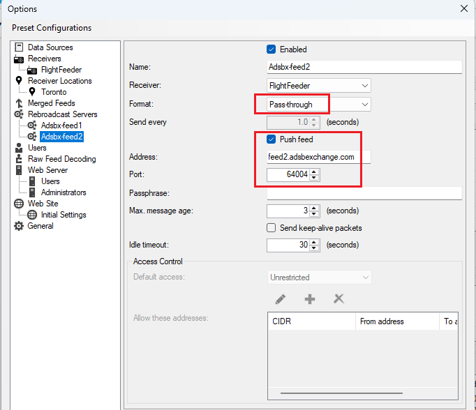

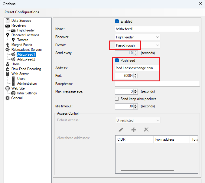

I think it is also possible to configure VRS running on Windows to receive data from Pi or FliightFeeder, and push it to Adsbexchange.
Screenshot 1 of 4 - Receiver Configuration
Screenshot 2 of 4 - Push-feed-1 Configuration
Screenshot 3 of 4 - Push-feed-2 Configuration
