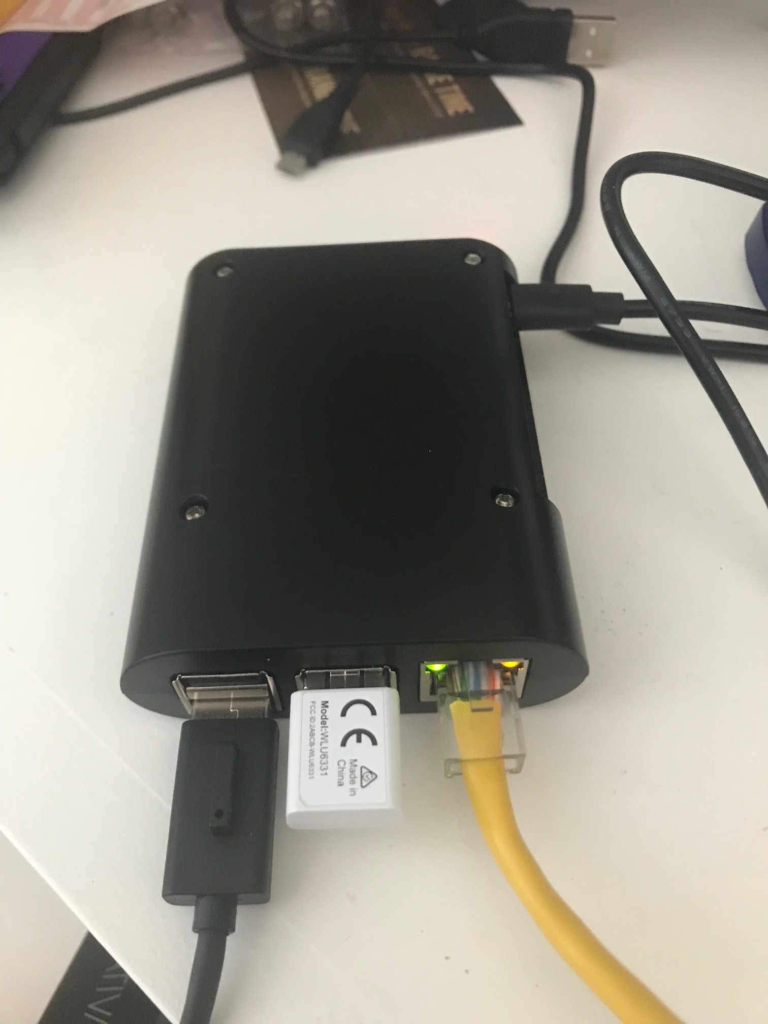

How should we know which Pi you have? Take a photo :slight_smile:
It looks like this:
Well, does not look like anything a screwdriver could not fix? Or is the dealer offering any special warranty with it?
Check on the other side for a slit for the mini-sd card.
That’s where it is, if the design of the case is not braindead it should be accessible.

OK! I have it open. I didn’t realize the black box was just a protective shell for the Pi.
