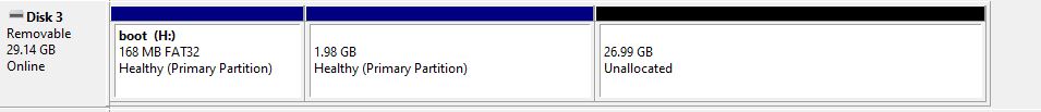

I followed the steps on PiAware - build your own ADS-B ground station for integration with FlightAware - FlightAware
sections 1 - 5. Using a 32Gb micro SD card (is there a max size? Well, that page links to a 32GB USB micro SD), twice I get:
1
2
The drive formats OK / read & writes OK in windows 10 pro.
Trying to see what’s on the disk (should it be readable in win 10?) the system says the disk needs to be formatted (in windows) first.
In drive management, I see this:
I WOULD try to boot off it on the pi, but haven’t gotten it yet. But I’m eager to get ready for it!!

The Healthy partition will expand after the first reboot.
After PiAware is installed Etcher should automatically eject the SD card, if not manually eject the SD card and remove from the computer.
Before you try and change the config, the sd-card needs to be unplugged / plugged in again so Windows updates it.
Only the boot partition will be readable for windows … there you can change the piaware-config.txt

Wiedohopf - I get that error after etcher says it’s done / before dealing with ejecting the card / channging the config.
And windows wants to format the disk rather than show me whats on the boot drive.

that is normal, because Windows cannot read the file system which is written by etcher. I am getting this message every time after flashing the card. Don’t let Windows format it.

I’m not familiar … is Etcher showing an error?
Your picture … doesn’t show context.
It is normally not an error in Etcher itself. This tool only reports “Finished!” in most cases
The error occurs when accessing the SD card in Windows Explorer after the flash process.
Your suggestion of ejecting and reinserting helps to access the boot file system to make the necessary changes.
