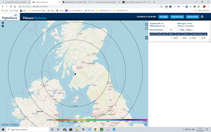

The map and site is loading properly but no aircraft? What are the stats on the right pane showing? Do you have a list of aircraft visible?
A screenshot would help

This is the current screenshot of my Skyview.

I typed the suggest command into my RPi but I cannot interpret to result other than dump1090 is active and running (in green)
Attached is my coverage over the last few days. Today is somewhat down on my normal exprerience but nevertheless still active. I’ve also check FR24 and I appear to be active there also.
