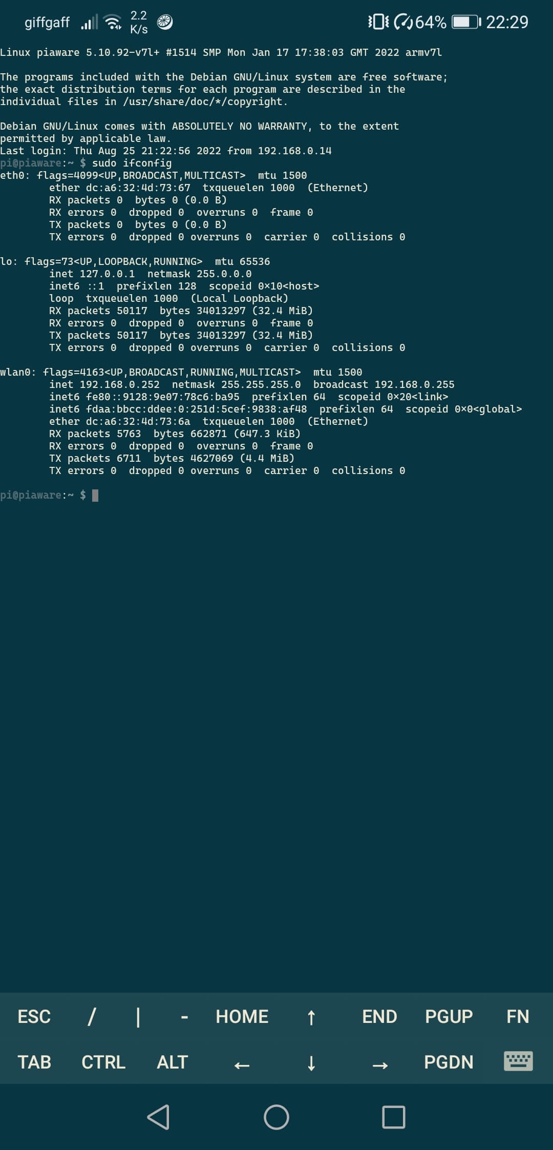

PI ifconfig

@Jonseyt23 post your piaware network config.
probably you set wrong broadcast or something.
and yes that can cause all kinds of unexpected / intermittent issues.
or maybe you recently added another device to the network and used the same IP?
or maybe you put the static IP in the DHCP range … that’s not good either.
