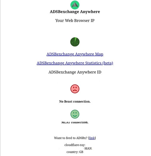

Think I have sussed it, I can keep the adsbx interface without hopefully feeding to them by just taking the TARGET and MLATSERVER out of the cat /etc/default/adsbexchange file,
their is no beast connection but MLAT is green and on the mlat feeder page it’s 0.0% on health, so can only assume their getting no data?

That’s better MLAT gone now
