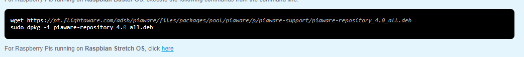

Old site is working fine. After getting new site up I was trying to add Flightware (https://pt.flightaware.com/adsb/piaware/install). After doing:
I am now getting:
pi@piaware:~ $ sudo apt-get update
Hit:1 http://flightaware.com/mirror/raspbian/raspbian stretch InRelease
Hit:2 http://flightaware.com/adsb/piaware/files/packages buster InRelease
Hit:3 http://flightaware.com/adsb/piaware/files/packages stretch InRelease
Hit:4 http://flightaware.com/mirror/raspberrypi/debian stretch InRelease
Reading package lists… Done
pi@piaware:~ $ sudo apt-get upgrade
Building dependency tree
Reading state information… Done
You might want to run ‘apt --fix-broken install’ to correct these.
The following packages have unmet dependencies:
piaware-release : Depends: piaware-support (= 4.0~bpo9+1) but 3.6.3 is installed
Depends: piaware (= 4.0~bpo9+1) but 3.6.3 is installed
Depends: beast-splitter (= 4.0~bpo9+1) but 3.6.3 is installed
Depends: dump1090-fa (= 4.0~bpo9+1) but 3.6.3 is installed
Depends: dump978-fa (= 4.0~bpo9+1) but it is not installed
Depends: skyaware978 (= 4.0~bpo9+1) but it is not installed
Depends: piaware-web (= 4.0~bpo9+1) but 3.6.3 is installed
E: Unmet dependencies. Try ‘apt --fix-broken install’ with no packages (or specify a solution).
any assistants will be greatly appreciated.
