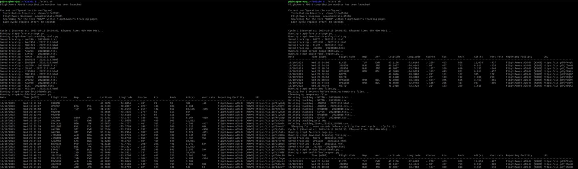

It is easy to monitor multiple receivers side-by-side.
When you are on the FA stats page for your first receiver, copy the part of the url which looks like:
www.flightaware.com/adsb/stats/user/USERNAME#stats-SITENUMBER`
When it asks “Please enter your FlightAware username” during installation, simply enter the entire bold part of the url as your username. For example:
When it asks “Please enter the term that will identify your ADS-B receiver”, just use the ICAO code for the receiver’s “Nearest Airport”.
You can repeat the installation several times, for each of your receivers, provided you just use a different installation directory for each receiver.
You can run multiple instances of this application side by side in seperate Terminal sessions:
Remember to be judicious about your “loop-frequency” setting in the config.me file. FlightAware sometimes prevents the tracklog page from loading properly if you try to access it too often.
