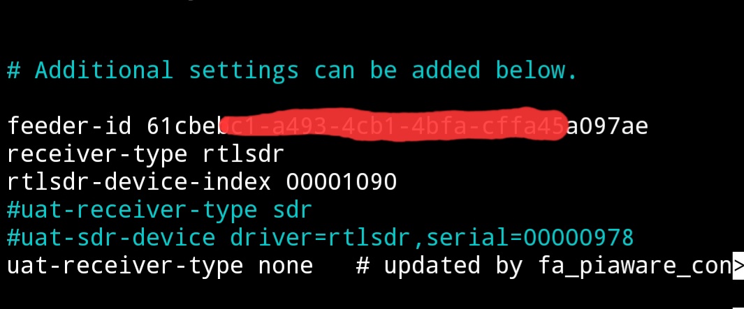

I could not find the "feeder-id: " on the “boot/piaware-config.txt” file so I added it to a blank like and saved the file.
Well instead of broadcasting to my Unique Identifier, it has created a new account # and I had to claim it to be able to see that it is working.
Did I put the "feeder-id: " in incorrectly?

Thanks but that’s where I put it originally.
I didn’t use “” nor have a line with a #

The punctuation marks " and : are causing the problem.
Remove " and :
The line should become like below (no punctuation marks)
feeder-id xxxxxxxxxxxxxxxxxxxxxxxxxxxxxxxxxxxxxxx

I deleted the semicolon “:” and saved the file.
Still not being linked to the original site and the new site is still working under the new #… ???
