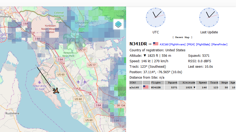

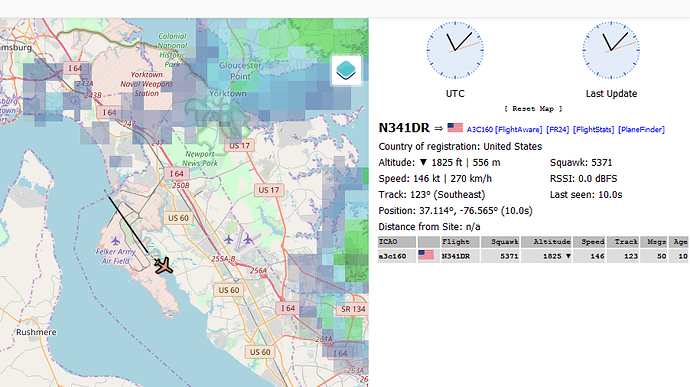

  1. Open file config.js for editing
    sudo nano /var/www/html/dump978/config.js
  2. In the file opened, scroll down to starting with SiteShow = false;
    change false to true
    // Center marker. If dump1090 provides a receiver location,
    // that location is used and these settings are ignored.
    SiteShow    = false;           // true to show a center marker
    SiteLat     = "43.xxxx"
    SiteLon     = "-79.xxxx"
    SiteName    = "My Radar Site"; // tooltip of the marker
  1. Save file (Ctrl+o) and close (Ctrl+x)
  2. Clear browser cache (Ctrl+Shift+Delete) and Reload (Ctrl+F5)
Before editing config.js
After editing config.js

That was it, thanks!
I remember seeing mentioned it somewhere by you, but I didn’t remember where (“bake a pi” maybe?), this new format is horrible.
And I didn’t need to refresh anything, the markers just appeared after save.
