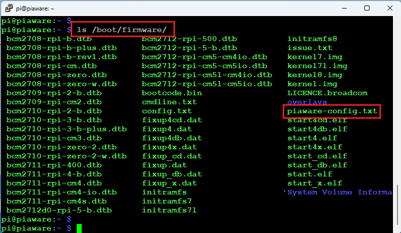

METHOD-2:
On first boot, the file piaware-config.txt is moved from /boot to /boot/firmware.
2.1 - After SSH to Pi, issue following command to open the file piaware-confug.txt
sudo nano /boot/firmware/piaware-config.txt
2.2 - Scroll down bottom of this file and add following lines
receiver-type none
uat-receiver-type sdr
2.3 - Save file
2.4 - Restart piaware to implement changes.
sudo systemctl restart piaware
