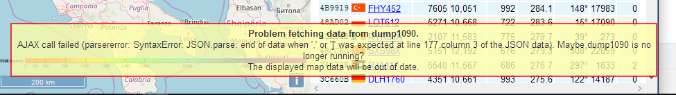

So I managed to get a screenshot when the error is displayed.
It looks like the errors are also in the lines 144, 170, 171, 174, 175, 176, 294 … I think I have not cached all errors, the displayed time is really short.
So, how can I fix this one?
I think i encountered the exact same problem.
Trying to remember what the problem was.
Ah yes the stat caching.
sudo lighty-enable-mod dump1090-fa-statcache
sudo systemctl restart lighttpd
Yeah i was just trying to see if dump1090-fa was constantly restarting or something. Just trying to get as much log information as possible. Luckily the json syntax error made me remember some error :wink:
I’m not sure why this config file isn’t enabled by default. Maybe it is and adsbreceiver switches it off or never on? I don’t know to be honest.
@ wiederhopf
THANK YOU, Dankeschön
Yeap that did the trick, or magic, call it how you want :slight_smile:
