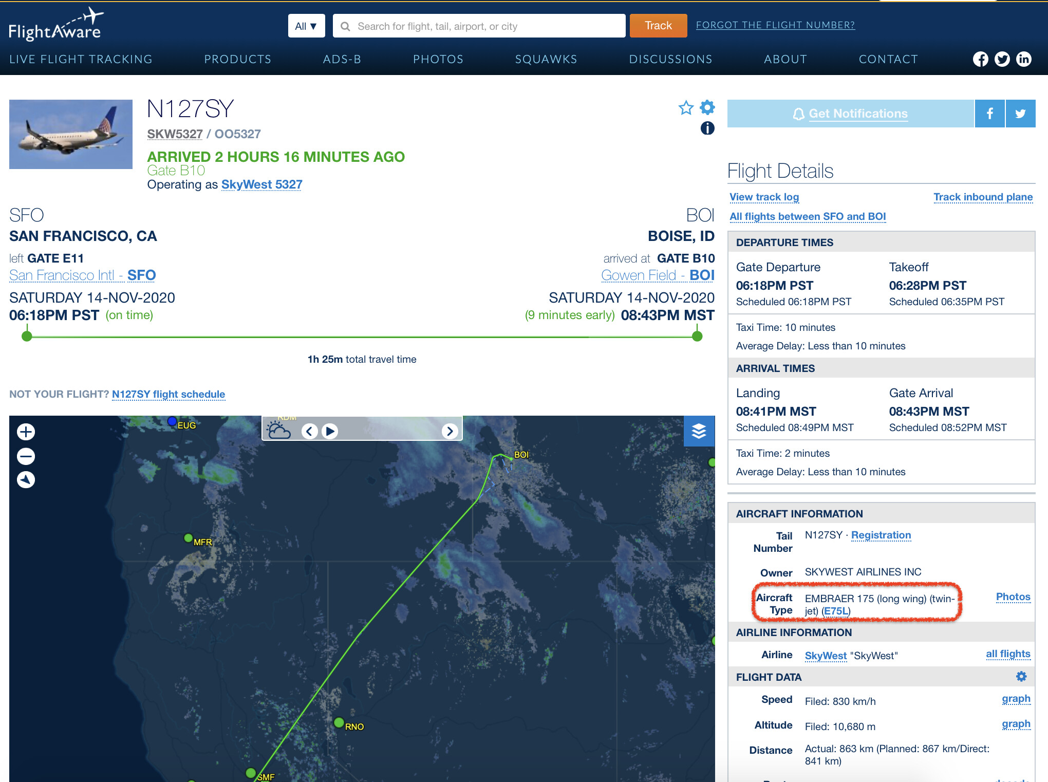

Yet code E75L is so prevalent, not only does it appear on airframes.org and ADSBx, but also on FA’s live flight pages, e.g.,
Note in the red circle, code “E75L” is linked to EMBRAER 175 (long wing) (twin-jet) (E75L) ✈ Aircraft Type - FlightAware.
It is the ICAO aircraft type designator. See Aircraft Type Designators
If ICAO already has a standardized designation, that should be preferable to ad hoc code extracted from aircraft’s model number. On the practical side, as the server-side live flight page is already automatically applying the ICAO type, the same automation could be used in PiAware DB maintenance and not add any cost.

In an ideal world, perhaps. In the real world, the registration information does not include the type designator, and we have to derive it from the model description; as I said above, the registration data is irregular, so this isn’t even a case of “just match on the model”.
The flight page has access to data sources that SkyAware does not, notably schedule and flight plan information that commonly includes type designators. This information is associated with the flight, not the aircraft (and can be unreliable)
