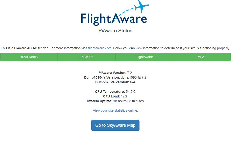

when you are up again you can also install piaware-web, this will install a webpage on the ip adress of your Pi and it will show you the status of the different needed processes.
If all is running well you will see the following
you can install it with the command
sudo apt install piaware-web
