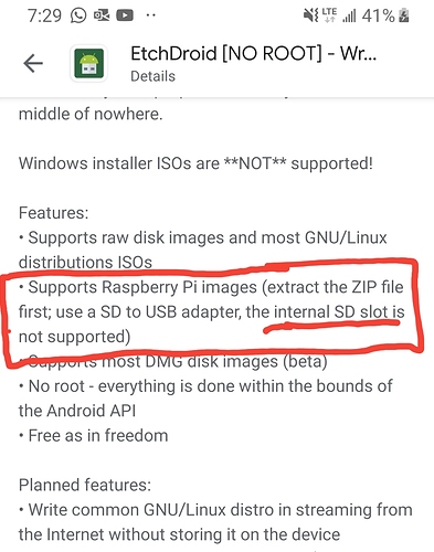

Today I wrote Piaware SD card image 3.8.1 using my Android phone (Samsung 8). The App I used is EtcherDroid. It is an open source app with source code at github . Hardware used was a USB card reader plugged into phone through USB-3 to USB-C adapter (supplied with the phone).

I just initialized a new 32 GB mSD and mounted it.
My phone does not have any provision to add an external memory card. The downloaded image is saved on internal memory. After it is saved, long-pressing it opens a popup menu which has many options, one of these is “Extract”. Click extract option, and the .zip image will be unzipped.
The App I used burned the image to microSD card inserted in a USB card reader. The card reader was plugged to phone through a USB-C to USB-3 adaptor.
