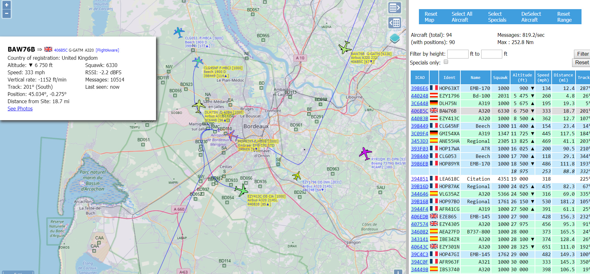

Hello thanks for the post
,I have nothing displayed in the name column?
Is there an option to enable in a file
Thank you
No idea what you are even talking about.
If you have a problem with SkyView please describe it clearly.
Maybe a screenshot?
What is that column even doing there?
What kind of installation are you using, that does not look like SkyView.
Please you need to provide more details …
Anyway in the ADS-B data there is only the Ident transmitted.
Not sure what should be in that column. Strange software you are using.
