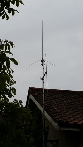

@glennblum What kind of antenna are you using? Indoor or outdoor? Thanks.
Outdoor at 30 feet. It’s a diamond ham radio antenna

half wave dipole out side vhf
top d777 used on pro 2006
I guess if I want this to work I need to put the antenna outside, on the pole with my ADS-B antennas. So far, I’ve just heard a few crackles.
