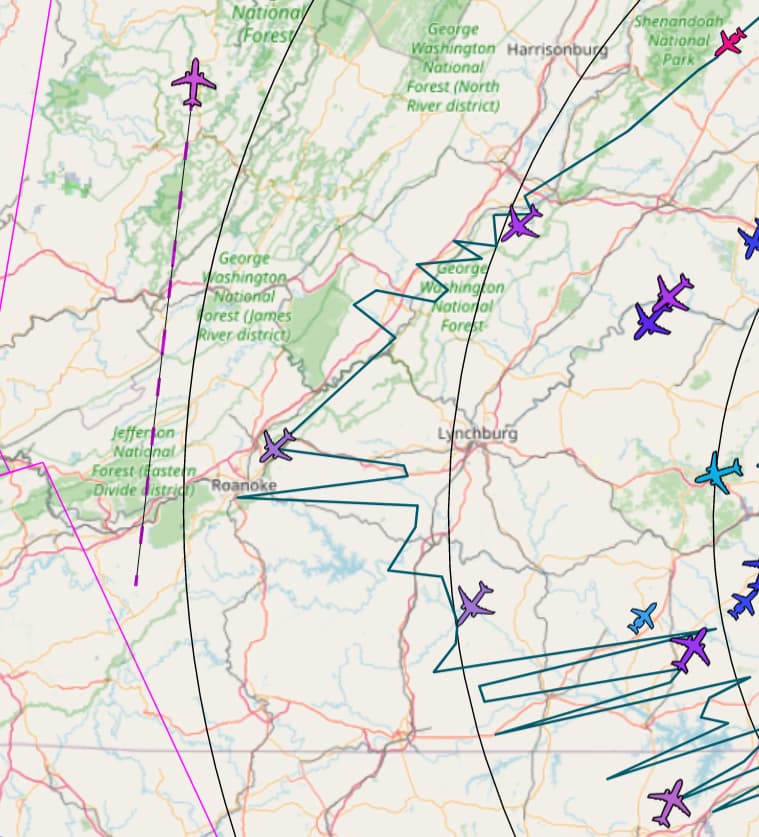

How the max distance received graph is working? I have a plane that is farther than the present position, but with intermittent reception. What’s the min duration of reception, because that plane doesn’t change the contour:
2 even, 2 odd CPR messages or not more than 8% over the previous max distance in that direction.
Actually, i’ve looked into making this a bit better for this purpose, do an update, it’s now 12% and the position reliability doesn’t time out as fast.
You still need to get two positions via global CPR (as opposed to local).
