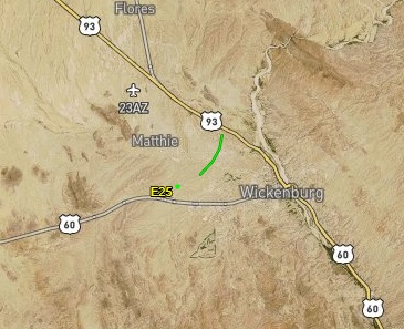

This is what happened this morning:
7-16
The tail number was showing for a while but now it’s not. The aircraft was in the air for an hour. This is just after take off. Elevation at times over 5000 feet. All within range.
Look at the signal levels of the aircraft in question. If they drop off quickly then it could be terrain shielding. It could also be receiver overload.

It was definitely not terrain related this morning. It dropped off pretty much directly over the antenna. Nothing in the way. Don’t know about overload. Should it not have picked back up when the aircraft was at 5000 feet and 30 miles away?
