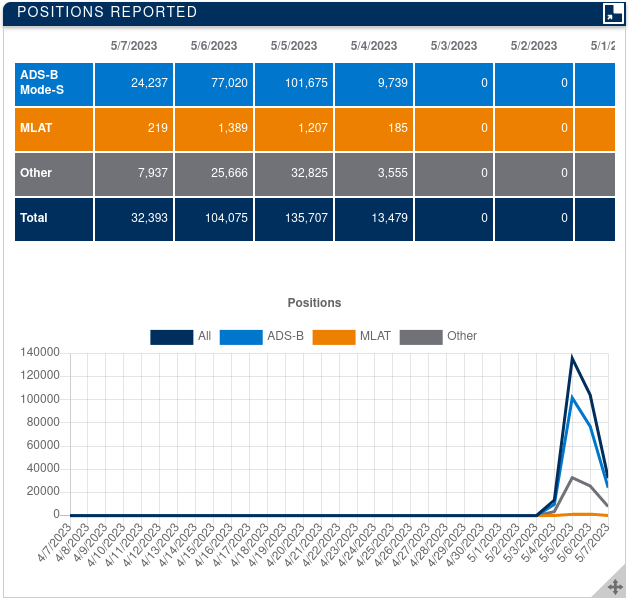

Further follow-up - my stats page is also only showing about 75-100k positions per day on this site. I know that’s not right.
Screenshot: FA Stats for site
During the day I average over 100 positions per second. If all positions are going to FA, I should be seeing much bigger numbers there.
Maybe FA only samples at about 2% in order to avoid overloading the servers? If this is intentional feed behavior, then problem solved.
The local view will show you the actual receiving rate locally. The sample rate for the Skyaware Anywhere is indeed lower since this data is first sent to the servers and then transported back. This delay is part of the reason you can see less aircraft in the Skyaware Anywhere view.
The sampling uploaded to the servers is also depending on the previous sent data as far as I know. If the timing isn’t exactly matched then the number of messages reaching the servers can be lower.
On average my upload rate is 18% towards the servers, and around 3000-3500 positions per 5 minutes.
Got it, thanks! I will assume all is well for now, and leave everything as is - that should let things settle down for at least 30d to see where I land.
