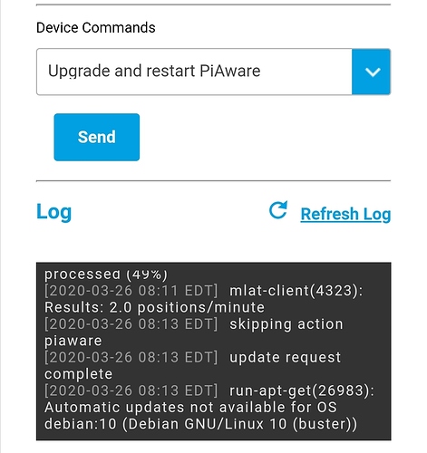

Upgrading Piaware 3.8.0 to Piaware 3.8.1 on Armbian Buster/OrangePiPC, package install - automatic upgrade NOT available.
