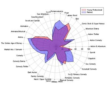

There is however one thing I don’t like about the FlightAware website. The coverage distribution plot (position vs range vs direction) is very hard to read. The pie with low numbers (<50 detected) is nearly the same as the white background and I have 20/20 vision. (Checked this with others and they had difficulty too). Can I change the colors used for my profile (example) or how can I contact the site owners to improve this?
