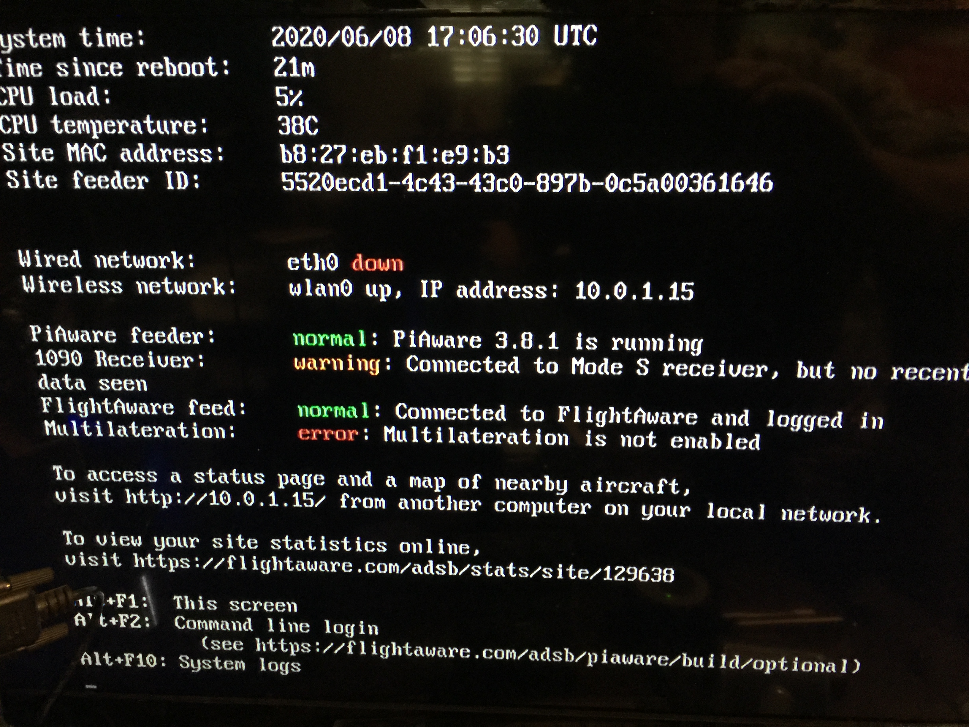

I feel likeI am SO close … But my Pi3 loads and stops per the attached screenshot.
What do you think I have done wrong?

That all looks normal, barring you not actually receiving any data. Check your antenna and antenna cabling.

Just received an automated email - FlightAware sees my setup - apparently you were correct - all is well.
I was “expecting” to see the live aviation map on my Pi … But now see I go to that site on another computer.

I was looking for a “detailed” explanation of the config text files on my SD Card … I thought that maybe I had messed it up somehow.

a live map is available on the Pi, but then you will need to install a graphical interface on it and access it through browser.
If you cannot or want not to install this, you will need a second device (can be any device with browser) to access the map.
