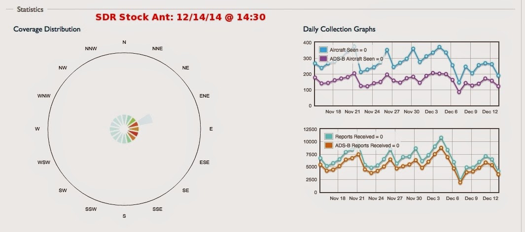

OK, I jut plugged in my new hand made antenna (reminds me of a miniature “Starduster” CB antenna I had a youth).
For now, to get a close to an apples-to-apples compare, I have placed it in the exact same location as the stock SDR cheapie antenna.
Too early to tell, but I immediately picked up two planes ~200 miles away which was not common for my rig.
I’m going to take so data for a week or so to analyze the results. If they are conclusive I will mount the new antenna in the attic.
Stay tuned and thanks for the idea…

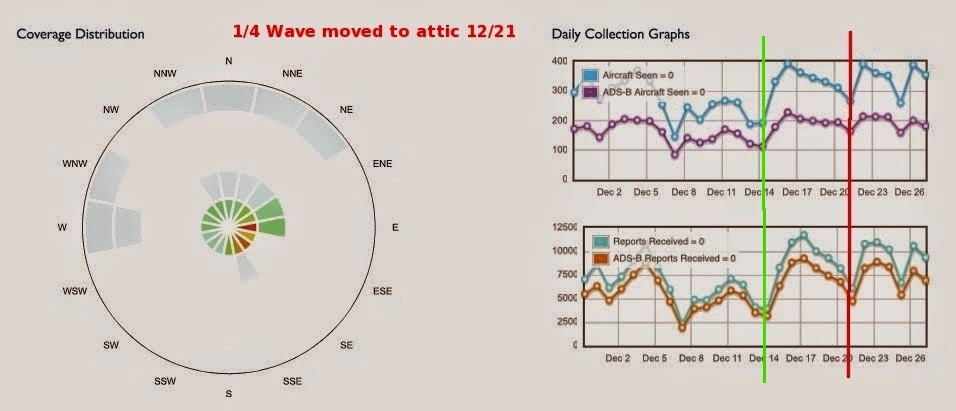

I started using 1/4 wave ground plane and the results are great.
That’s not great - that’s fantastic! Good work! :smiley:

I moved my cantenna to the top of my antenna mast today and results improved a lot. I’m testing it against my ground plane.

I just finished my testing. Details http://www.whiskeytangohotel.com/2014/12/diy-antenna-improves-raspi-ads-b.html
The quickie answer is my DIY 1/4 wave was nice improvement, but not nearly as good as above.
It short, I am glad I did it. Thanks to the others for leading the way.
