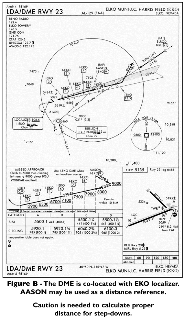

Isn’t what you describe above similar to the figure B in my reference?
aopa.org/images/whatsnew/new … 13figb.gif
While more step downs based on DME from EKO then what you described for your approach, there are no intersecting fixes to validate the DME fix along the localizer.
Use Bullion for DME and you’ll see what I described.
This “figure” approach does take being ahead of the plane, but not that hard of an approach.
Bullion confirms the IAF of AASON as a cross check of 9 miles from EKO
I would have my NAV1 set to EKO of 108.5 with the 239 radial dialed in and NAV two set to BQU of 114.5 with the 031 radial dialed in.
Assuming vectors to final, I would expect track the 239 radial and once NAV 2 centered up on the 031 radial, start my descent based on the DME fixes.
Since I don’t have DME, I would have to rely on my GPS to give me my DME from the EKO VOR which would be perfectly legal from all I read. I would personally put EKO as my waypoint in the GPS to ensure DME accuracy, not sure how others would do this. I would not load the localizer approach.
My course guidance would be strictly based on NAV1 and NOT the GPS.
Assuming full procedure, I would fly on the 031 radial from BQU and execute the procedure turn when my Nav1 centered up on the 239 radial and I flew outbound 13.5 DMA to the intersection 040 radial of BQU (while flying outbound on the 239 radial I would reset Nav 2 to 040 to help cross check where I should start my procedure turn) . After my procedure turn, the DME fixes along the localizer course line would help me make my descent.
In the real world of piloting, I would not do this (way too much work!), but what I describe above would be perfectly legal using the GPS as a replacement for DME from everything I have read. I am not using the GPS for course navigation in my above example.
In the real world of flying I would elect the VOR approach for the lower minimums with what I have in my plane.

Help me then? You said GPS cannot be used for a DME approach. Where am I wrong?
You point out a VOR that requires the use of a DME and a radial?
Altitude is 9000 that steps down to 8300 on the final approach course line at a DME distance from the VOR you bring out.
What am I missing?
