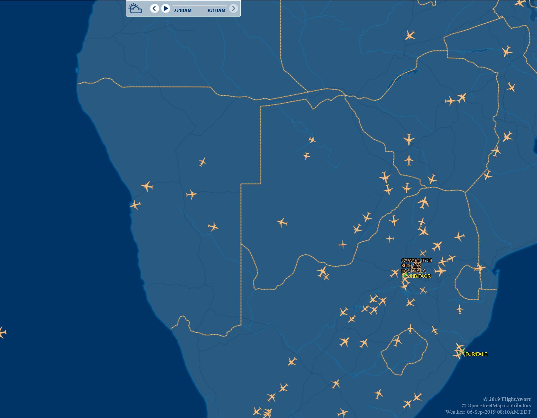

I don’t know how is your local relief and obstructions, at some point, raising the antenna brings minimal gains. It doesn’t look like you can get much more flights than what you get now in your location (I think you are in center of Namibia):

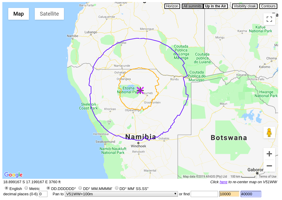

You should really create a panorama like this one: HeyWhatsThat
It is described in this thread: What is the Maximum Range I can Get?
It doesn’t factor in trees and buildings though.

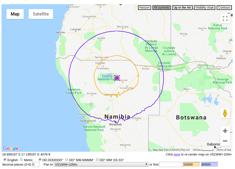

Did you zoom out the map and adjust the blue circle from 30000 to 40000 ft?
The difference at your (approximate) location for 3m above ground and 100 m above ground:
i just did air view
click it and put the curser see details
