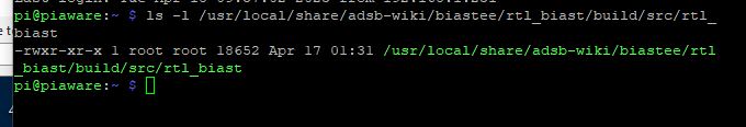

ls -l /usr/local/share/adsb-wiki/biastee/rtl_biast/build/src/rtl_biast
I installed the PiAware image. I assume I’m running dump1090-fa. How would I confirm?
Here is the output from running the command you suggested.
Putty output 20230418-2
What does the output indicate?
I went with PiAware because that seemed to be the easiest for a beginner like me. Would switching the readsb, tar1090 and/or other @wiedehopf projects resolve the bias t issue or provide other benefits? If so, how do I switch without losing my FlightAware streak?
It confirms that the executable rtl_biast has been built and is in correct location
