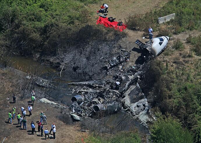

Engines look ok from the air.
Looks like the fire was from wing tank(s) and/or center cabin?
https://pbs.twimg.com/media/BpJIuKTIYAAk2Wf.jpg:large

The engines look alright from all the way over here, so that can’t be the fault.
I would say that the fire didn’t start in the cockpit or the tail as they aren’t burned as much as the fuselage and wings, maybe the fuel burned after the crash.

I can’t speak for anyone else, but what I meant was that the fire didn’t start in the engines… because they still look shiny and whole in the photo. I wasn’t trying to say they were operating normally. Or at all.
