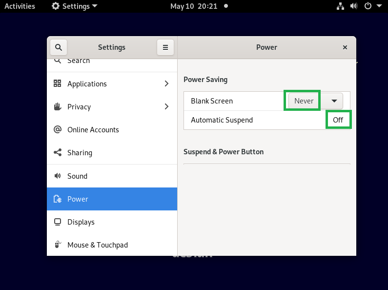

I have installed Debian 11.3, dump1090-fa & piaware on the on-board SSD.
However I faced a problem that the Thin-Client went to “suspend” mode after about 15 minutes, and wont come out of it even if I click any key on keyboard, or click mouse, or pressed the power button. When in suspended mode, SSH, piaware, & dump1090-fa stopped working. The only way I could tak it out of suspension was to disconnect then reconnect power.
I disabled “suspended” mode from Gnome settings, as shown below, but suspension did not stop
Screenshot 1: Default Power Setting
Screenshot 2: Modified Power Setting
I then got fed up and decided to re-install Debian 11.3 , but this time without “Desktop Environment” and “Gnome”, i.e. headless or as Server, as shown below. By this way of installation, the Debian 11 stopped suspending.
Installing Debian 11.3 “Headless” (i.e. as Server) on Thin-Client HP T-520
This “headless” or “server” installation of Debian 11.3 fixed the problem of “suspension”. However I lost facility to configure WiFi and Fixed IP. I solved this by installing Network Manager and run nmtui
