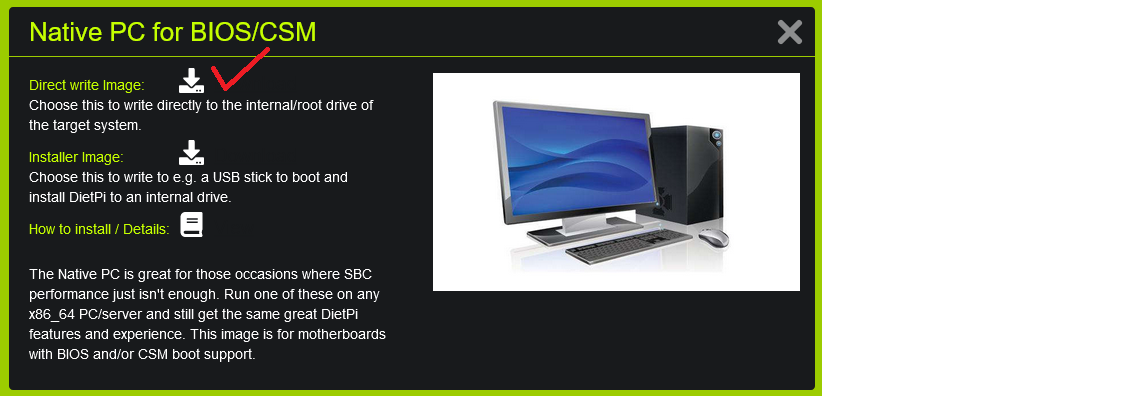

(1-2) Scroll down till you see following. Click on " Native PC for BIOS/CSM x86_64"
(1-3) Download “Direct write Image”

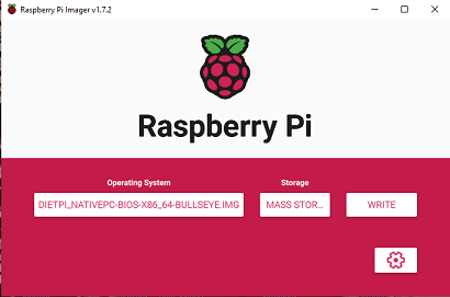

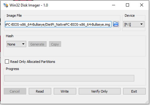

(1-5) Use Raspberry Pi Imager or Win32 Disk Imager or Balena Etcher to write the extracted image to microSD card

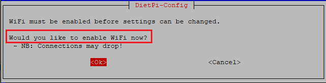

(2-1) Give following command

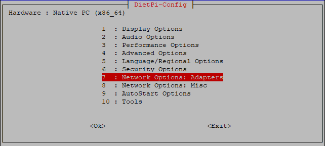

sudo dietpi-config

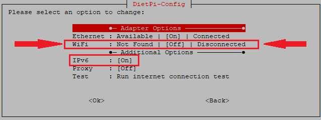

On dialogue box opened, scroll down to “7: Network Options: Adapters”, and press Enter key
(2-2) on the dialogue opened you will see WiFi has three negatives, (a) the adapter is not found, (b) wifi is set OFF, and (c) IPV6 is ON. Highlight the WiFi line and press Enter Key to turn it ON. Hilight IPv6 line and press Enter key to turn IPv6 OFF.

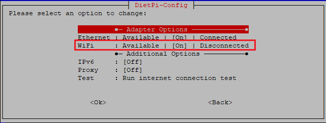

(2-4) After above activation of WiFi module, do following:
sudo dietpi-config
(2-4a) Go to Network Adapters option, and you will see that WiFi Adapter is now available and ON, but disconnected

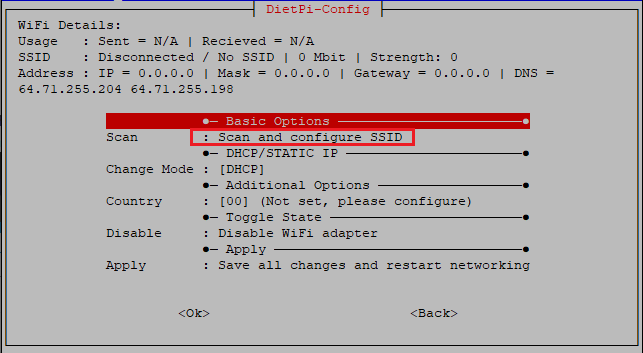

(2-4b) Scroll to WiFi line and press Enter key. Following dialouge will open.

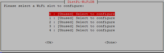

(2-4c) Scroll to “Scan and configure SSID”, press Enter key, following dialouge will open. Scroll to item 0 and press Enter key and configure your SSID & WiFi password

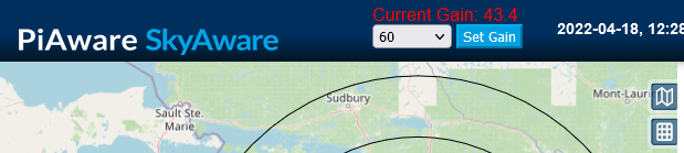

(5) Embeding Set-Gain Button in Skyaware Map (For manually setting the gain)
https://github.com/abcd567a/set-gain/blob/master/README.md
