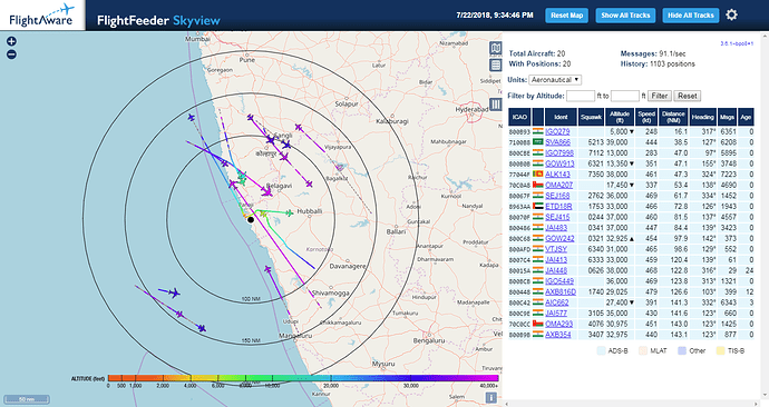

Why has this skyview stopped showing altitude?
The Skyview Aircraft Altitude in the table is still available.
Not for me… Check 103.98.85.245:3010
I may have to downgrade
That’s odd… The screenshot is perfect…
Wonder if its a problem with my browser. Have only checked on my mobile so far…
Thanks for checking it out… Will check from my laptop tomorrow
try forcing a complete reload of the page (not sure how that is accomplished on your mobile device)
Try to reload / refresh your browser.
Or try to delete all the cache files in the browser.
Good luck.
