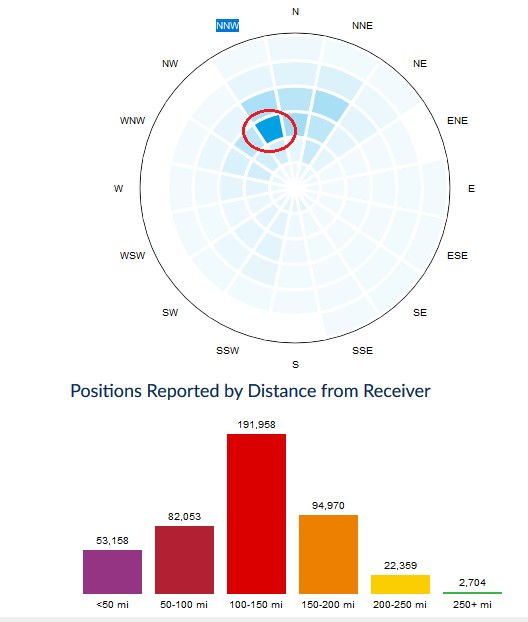

And if you look, it seems that the bulk of his numbers are fairly close-by, 100-150 miles.

I also notice that most of his signals are coming from his “NNW” sector. Like it is indeed another receiver located there.
This is because the air traffic here goes NNE-SW, from NY/DC area to Florida and South America. You can see it on my heat map.
But his looks like this:
