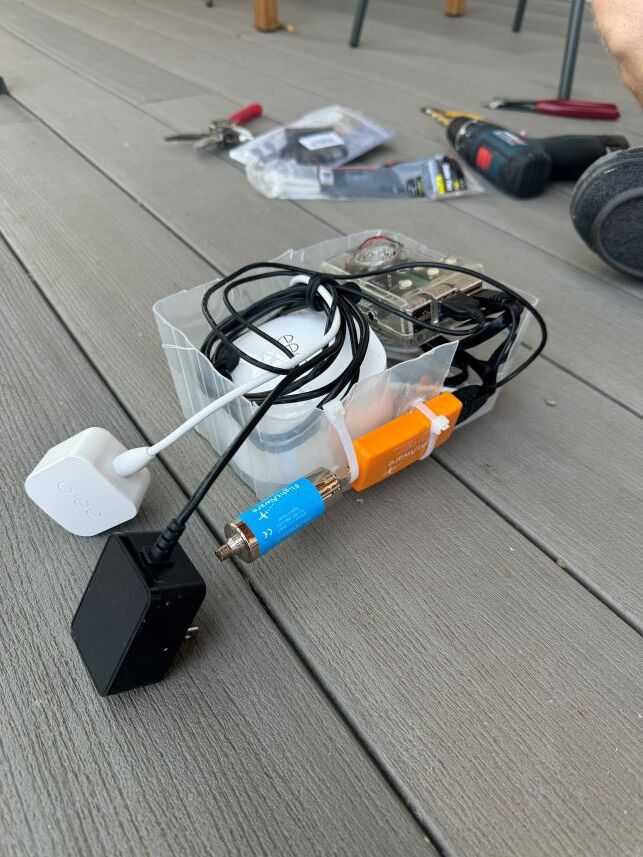

Feel free to take a picture of the setup.
I mean, if I saw anything out to 200 nm then it would blow my mind. As it stands, I’ve never gotten much beyond 50 - even at the old location with the metal roof.
Yes, I’ve had the filter attached for a couple of years now. Antenna to filter to FA stick to Pi. Here’s a photo from the move this past weekend:
The white component is a wifi bridge. Yup, I guess I left that out. The Pi has always been connected to it, but at the old location was located several feet from it. In the new location, this isn’t possible, so we bundled everything together and mounted it just below the roof overhang.
I guess this could be a source of interference?
But RF noise is RF noise. You can’t expect to hear a concerto from across the room if you have AC/DC blasting next to your head!

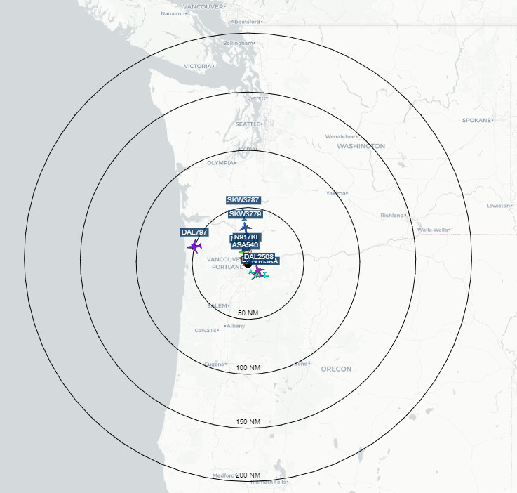

That is a truly baron aircraft environment out to 200nm. Hard to imagine the air traffic in that region could be that sparse.
This is my view at 6:20pm during off peak traffic.
Oh for sure, especially with Seattle and Vancouver, BC up there - not to mention north/south traffic to my west to/from SFO, LAX, etc. This is very much tied to issues with my setup.

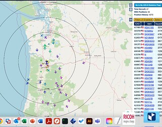

KPDX (Portland Int. Airport) is not baron. See the attached screenshot of https://globe.adsbexchange.com/
The red arrow points to KPDX
Here’s what I am seeing near PDX at nearly 9pm on a Wednesday. It will pick up slightly in about an hour and then drop off until around 6am.
During the day I hover between 60-90ish active aircraft at any given time.
What you’re showing is what I was thinking it would be. I was referring politely to what his view of the area was showing.
