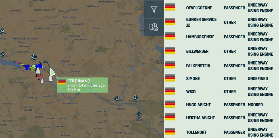

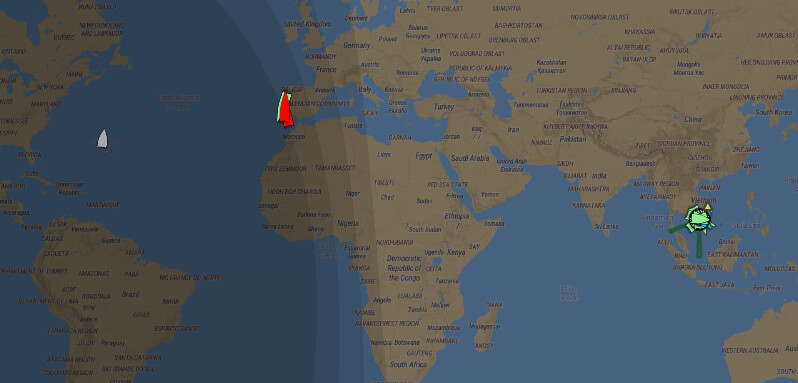

The VHF DX seems quite hot at the moment. Anyone else seeing (real) ships at very long distances?
(I’ve confirmed these ship are where they seem to be - just over 5500 Nm)
This looks like someone is rebroadcasting the location of specific ships.
Certainly these transmissions are not being received directly from the ships themselves.
Are the far away ships members of a specific fleet or have something else in common?
Can’t see anything in common other than geographic location.
I’ve just had another 13 ship (visible about 2min) around Hamburg

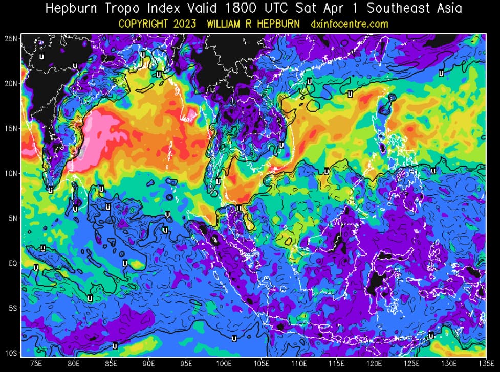

The Hepburn predictions say propagation is very strong in my area, so I’m thinking they might be real.
I found this post helpful to me understanding VHF propagation in the 2m band which is right around where AIS lives. The aptly named phenomenon “The Magic Gradient” could explain very brief and very long distance contacts. The strong overall ducting in your area likely helps, too.

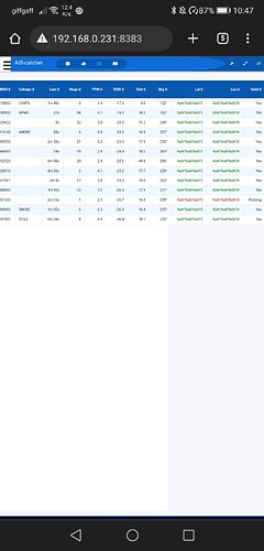

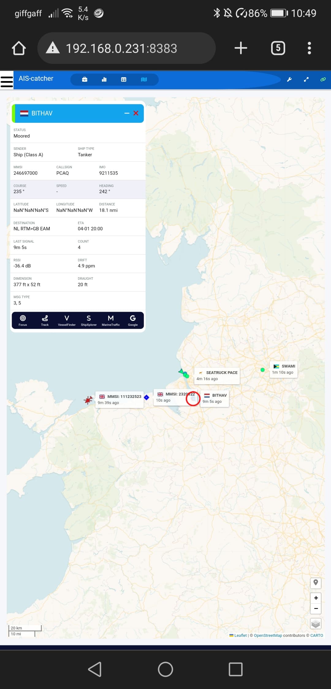

My lat/lon plug in has gone to pot, redid the plug in from the text on the github site, but still not working properly. All the rest look fine and work
If they are real then I am surprised that there don’t seem to be reports of any similar distance contacts in the 2m amateur band. As far as I am aware the current distance record on 2m is around 4500km whereas your’s are over double that. Interesting.
To fix your problem, there are two options:
Option 1:
Delete lat-lon plugin from folder my-plugin. Without plugin, the lat-lon will start displaying in decimal degrees
sudo rm /usr/share/aiscatcher/my-plugins/latlon_in_dms.pjs
sudo systemctl restart aiscatcher
Option-2:
The plugins downloaded from github are saved here:
/usr/share/aiscatcher/AIS-catcher/plugins
A copy of these plugins is made during installation here, and is used by the AIS-catcher
Copy downloaded plugin to the in-use plugin folder by following command
sudo cp /usr/share/aiscatcher/AIS-catcher/plugins/latlon_in_dms.pjs /usr/share/aiscatcher/my-plugins/
