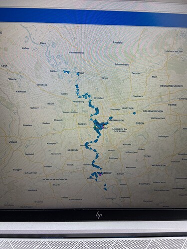

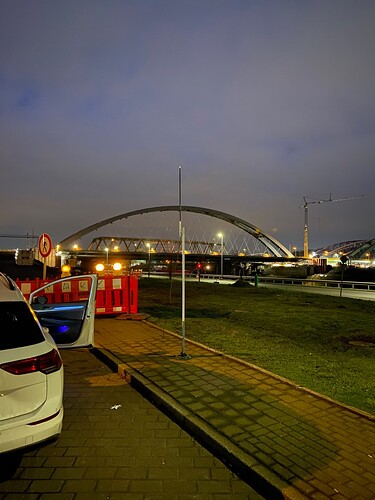

Today, I drove a few miles to the intersection of the rivers Rhine and Ruhr, where there is a big industrial port there, as well.
Quite a lot to “see” there, these are the signals picked up from my home made cloth hanger antenna after a few minutes.
Regarding the vinnant AIS, it has now suddenly started to pick up signals as well, but whatever I try, it still performs decisively worse than my home made version. I still think it is broken, or it is just bad for this purpose…

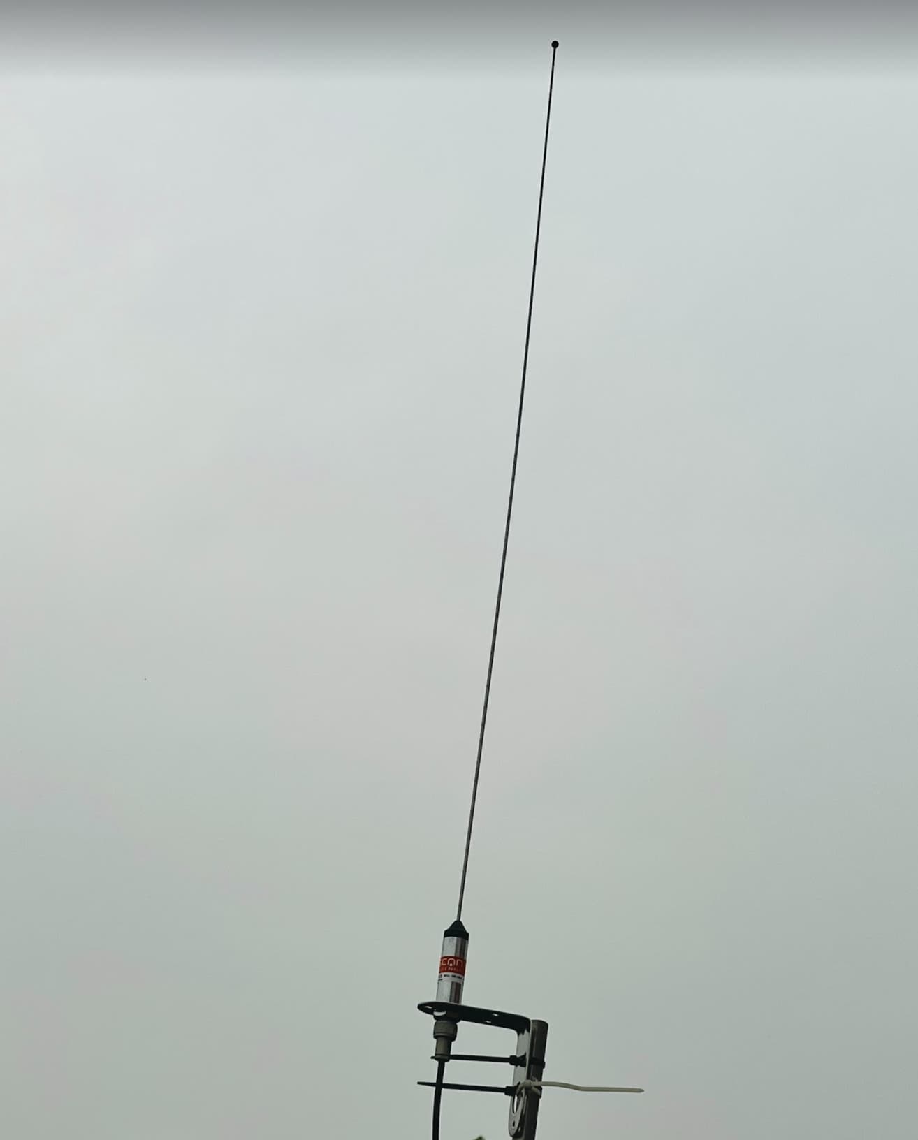

I found that antenna for AIS signal is rather simple.
Even I plug dongle accidentally to my TV antenna, it’s still can pick up some nearby ships.
The best one made is just a plain copper wire (no coil or balun) d=1.5mm * L = lambda * 5/8 * 0.95 = 1074 mm.
The ideal materal is a stainless steel rod d= 2~3 mm like VHF23 here

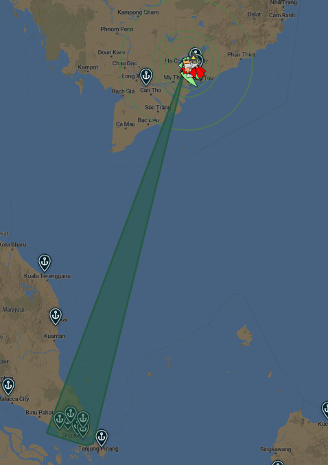

I’ve just another “almost plausible” DX. This time Shipxplorer is showing it.
Again, I didn’t see it soon enough to see the ship that is supposed to have sent the data.
(range is 600NM)

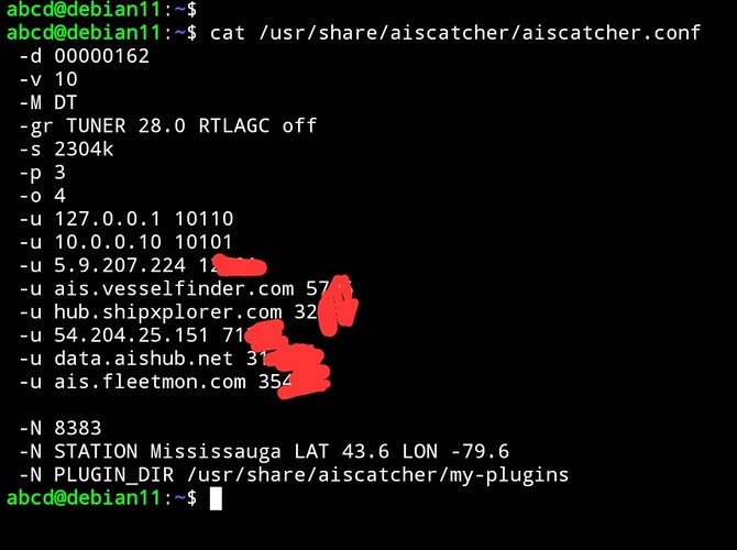

Feed directly from AIS-catcher
For each station, add following
-u [URL or IP] [PORT]
Automated installation of AIS-catcher:
https://github.com/abcd567a/install-aiscatcher

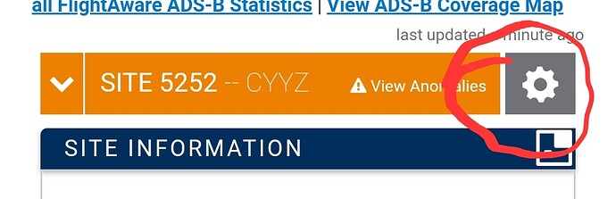

Which MLAT?
Flightaware or Flightradar24?
If you have problem with FR24 mlat, then this is because FR24 allows Mlat from RPi only, that also if you choose “receiver=dvbt”
For Flightaware Mlat to work you need to enter your location (latiyude and longitude) on your myADSB page by clicking gear icon at top-right and scrolling down to find location settings option.
https://flightaware.com/adsb/stats/user/
Thanks! I remember that fr24 stopped using MLAT from other decoders and for Flightaware i forgot about gearbox option. Now it is all OK. Two dongles are working just fine, one for AIS one for ADS-b, CPU/network usage is low so there is maybe space for another one for live atc stream, weather balloon chasing software or something like that.
