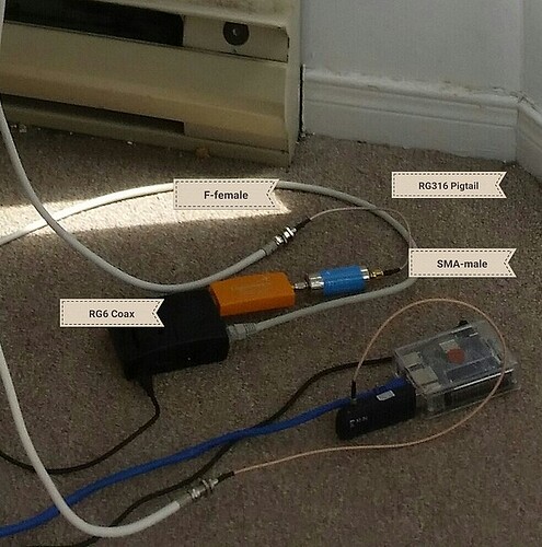

I had 2 Pis with DVB-T, and on one of these I replaced DVB-T by ProStick+Filter. You will need a pigtail or adaptor with SMA-male connector to connect the antenna to filter.
Please see photos of my setup. From antenna to receiver, I use RG6 coax with F adaptor, hence I use F to SMA pigtail. You will require pigtail/adaptor according to your coax cable.
F-female to SMA-male Pigtail RG316 20cm from eBay.ca
Be careful. Dont purchase RP-SMA male. It looks like SMA male, but if you look carefully, you will find it does not have a center pin.
Dont purchase any pigtail which says “wifi” or “wlan”, as these use the RP-SMA.

I have 2 setups. Please see the photo of my setup, which I have posted in my post above.
My stats show the FA combo gives much better performance: Message rate 182%, Plane count 114%
Pi-1: Cantenna + 12 ft RG6 Coax + 12 inch RG316 pigtail + Black DVB-T (No Amplifier) >> plugged directly into OPi PC
Pi-2: FA Antenna + 4 ft RG6 Coax + 4 inch RG316 pigtail + FA Filter + ProStick >> plugged directly into RPi Model2
