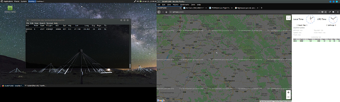

Just looked at that greentech web page. There was some data - shown below. So working but not very well?
Edit: Perhaps it is working fine. Looking at FR24 for locations, I saw it picking up targets at 150nm. But a very narrow window. Aircraft over Oradea but for a very short time, Need to consider antenna location.
ICAO Ident Squawk Altitude (ft) Speed (kt) Distance (NM) Heading Msgs Age
471F78 Flag 5650 28,575 ▼ 398 120.8 304° 52 18
885176 Flag THA917 32,975 512 135.1 114° 107 27
8960CD Flag 4721 35,000 64 2
