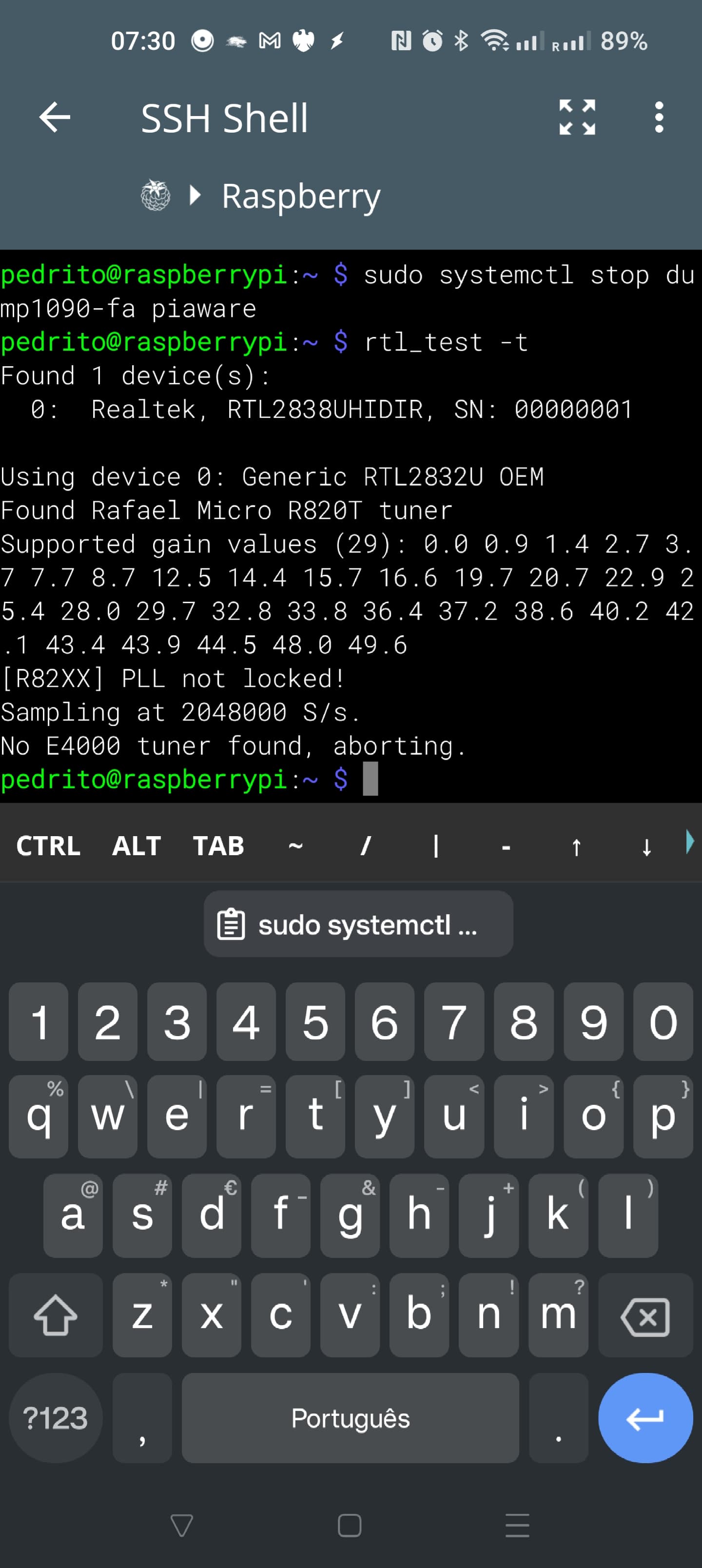

I’m a newbie but followed all instructions I could find and nothing seems to work. After a reboot, dump1090-fa no longer finds the USB
(1) Please post output of following command
lsusb
(2) Please issue following commands and post output of last command
sudo systemctl stop dump1090-fa piaware
rtl_test -t
Abcd567 you are a legend. Thank you for your help. Here are the results:
Great!
Your dongle is healthy and available for use by dump1090-fa.
You can check this by following commands:
sudo systemctl restart dump1090-fa
sudo systemctl status dump1090-fa
After 10 minutes:
sudo systemctl status piaware

Followed your instructions and again the same problem on a a test.
I haven’t rebooted.
The error (usb_claim_interface error -6) on conducting rtl_test -t is shown because the SDR is NOT free for test, it is being used by dump1090-fa.
You have to first STOP dump1090-fa, then run the test, like below:
rtl_test -t
After test, RESTART dump1090-fa
