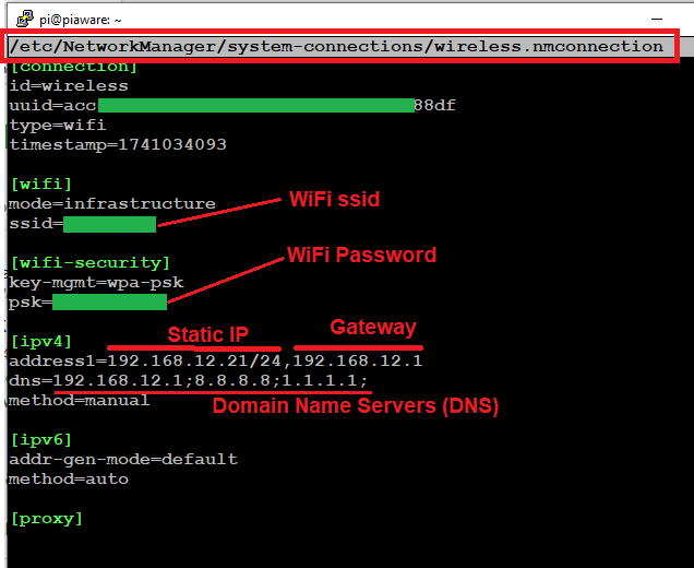

The utility nmtui (network manager text user interface) saves WiFi Configuration in following file:
/etc/NetworkManager/system-connections/wireless.nmconnection
Click on Screenshot to See Larger Size Image

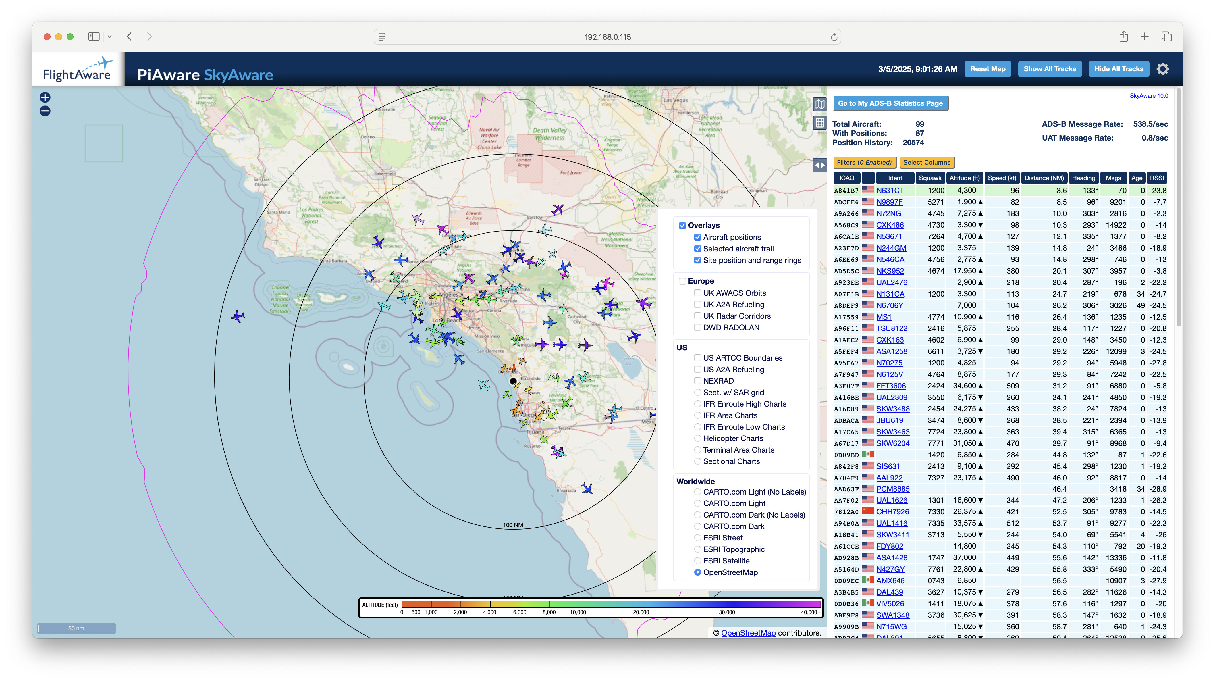

With the dump1090-fa upgrade to V10, I don’t see the FAA IFR VFR overlays. I did see that the mobile version of SkyAware is improved as abcd567 showed. That would be a nice change for SkyAware Anyware also.
Click the OpenLayers icon on the bottom right corner and they should be under the US layers

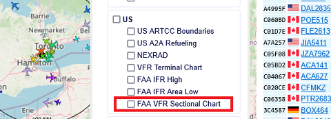

FAA VFR Sectional Chart is not an option on my screen.
It is available on my Windows PC
Problem seems specific to Mac PC
You are on a Mac PC.
Yes, I’m on a Mac with Safari browser. But don’t know why that would make a difference
Ahh – did empty caches in the browser and that fixed it. Thanks.

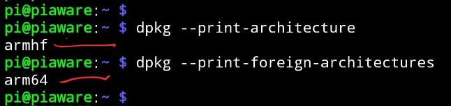

The latest piaware SD card image has 64-bit OS Bookworm, but piaware ver 10 package is 32-bit.
This arrangement works OK as the 64-bit Raspberry Pi OS is compatible to both 64-bit and 32-bit packages

My setup shows exact opposite of yours:
pi@raspberrypi:~ $ dpkg --print-architecture
arm64
pi@raspberrypi:~ $ dpkg --print-foreign-architectures
armhf
pi@raspberrypi:~ $ apt-cache policy piaware:arm64
piaware:
  Installed: 10.0
  Candidate: 10.0
  Version table:
 *** 10.0 100
        100 /var/lib/dpkg/status
     9.0.1 500
        500 http://flightaware.com/adsb/piaware/files/packages bookworm/piaware arm64 Packages
pi@raspberrypi:~ $ apt-cache policy piaware:armhf
piaware:armhf:
  Installed: (none)
  Candidate: 9.0.1
  Version table:
     9.0.1 500
        500 http://flightaware.com/adsb/piaware/files/packages bookworm/piaware armhf Packages
Please note the difference:
piaware SDcard img vs RaspberryPi OS img
pi@piaware:~ $ - mine
pi@raspberrypi:~ $ - yours
