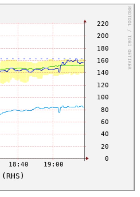

I also see increase in message rate ![]()
None on my Pi4, but maybe depends how much traffic you see. ![]()
There will be definitely more decodes. I suspect that’s why the CPU usage also increased in your case.
OK. @wiedehopf proposed a few other optimizations. Let’s try them.
Similar message count, but significantly less a/c, compared to @bramjacobse ![]()
That was meant in comparison to @bramjacobse‘s feeder ![]()
More Airspy CPU usage, more overall CPU. Otherwise, similar as before.
