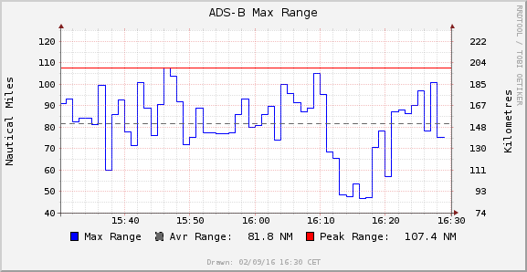

how can I adjust the graphic on my real max range⦠? My Max Range are about 220km

antonov124,
Do you have an older setup?
My graphs peak at the red line.
jonhawkes2030, you are correct. I updated that graph recently to remove the surplus 250nm line.
antonov124, update the script and just run the portal section again; this will update the graph definitions.

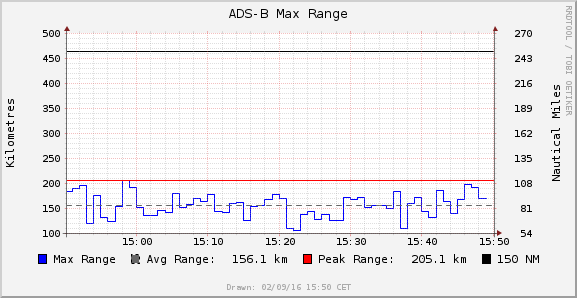

i had do deleted the adsb-feeder an reinstall everything now it looks okay
BUT the rest looks veeeeerrryy emty:
You currently have the range graph set to nautical miles and that always displayed OK. Itās the metric graph that still as an extra line at 250nm but I have submitted a request to remove that. As for the other empty graphs⦠I donāt know what is causing them.
i changed it to metric now the range is km
Yes but I think you still have a black line at 250 NM. This should be removed soon with the next update of the scripts.
Oh okay, the red line is okay
the black line at 250nm is over the top ^^
@mgunther fix has been merged.
If you refresh and re-run the install.sh again now, that black line should disappear.
antonov124:
yeah - thx

BUT the rest looks veeeeerrryy emty:You currently have the range graph set to nautical miles and that always displayed OK. Itās the metric graph that still as an extra line at 250nm but I have submitted a request to remove that. As for the other empty graphs⦠I donāt know what is causing them.
Where can that graph be changed to miles and not nautical miles?
Thatās not easily done right now. If you are comfortable editing files yourself, it is in:
/home/pi/adsb-feeder/build/portal/graphs/make-collectd-graphs.sh
You would want to edit the following routine:
range_graph_imperial()
and change the calculations.
Anything you do there will be overwritten next time you run the install.sh script.
