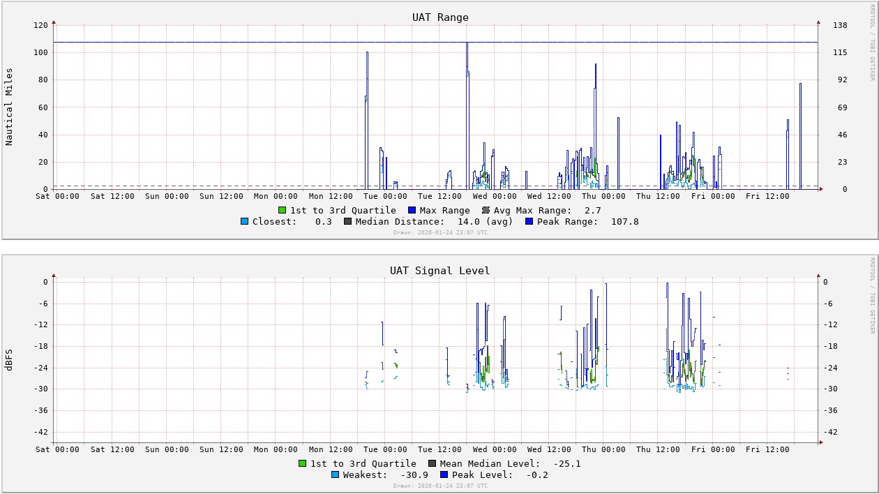

Last few days have looked like this (I flashed a new card with the piaware image, so the data is only since Tuesday on these graphs). And antennas are indoors so I would expect much better if/when I put them outside.
Yep. I have a pair of 978 and 1090 filtered/amplified receiver dongles from another project. That was exactly the plan. Thanks for the link, I couldn’t find it with a search.
